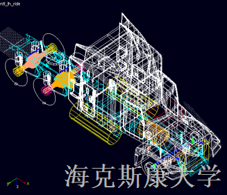

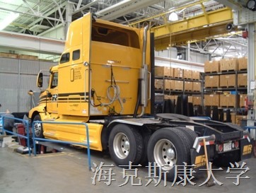

•Challenge: A prototype vehicle was tested on public roads and proving grounds and a front wheel shimmy problem was observed at specific vehicle speeds and road conditions. Vehicle dynamics simulation and analysis were requested in order to understand the shimmy phenomenon and seek acceptable modifications to the design of the front axle and suspension.
•Front wheel shimmy occurs at 6-7 Hz, and sustained at vehicle speeds greater than 30 mph

•Solution: Sensitivity analysis with MSC.ADAMS truck model with
•Truck frame: modal neutral file from MSC.Nastran
•Front suspension: mechanical leaf spring (beam elements), air spring (nonlinear force-deflection curve), and shock absorbers (nonlinear force-velocity curves)
•Rear suspension: trailing arm (beam elements) and air springs
•Steering system: pitman arm, drag link, steering arm, tie rod arms, cross tube
•Cab, engine, transmission: rigid bodies
•Tires: Pacejka magic formula tire model
